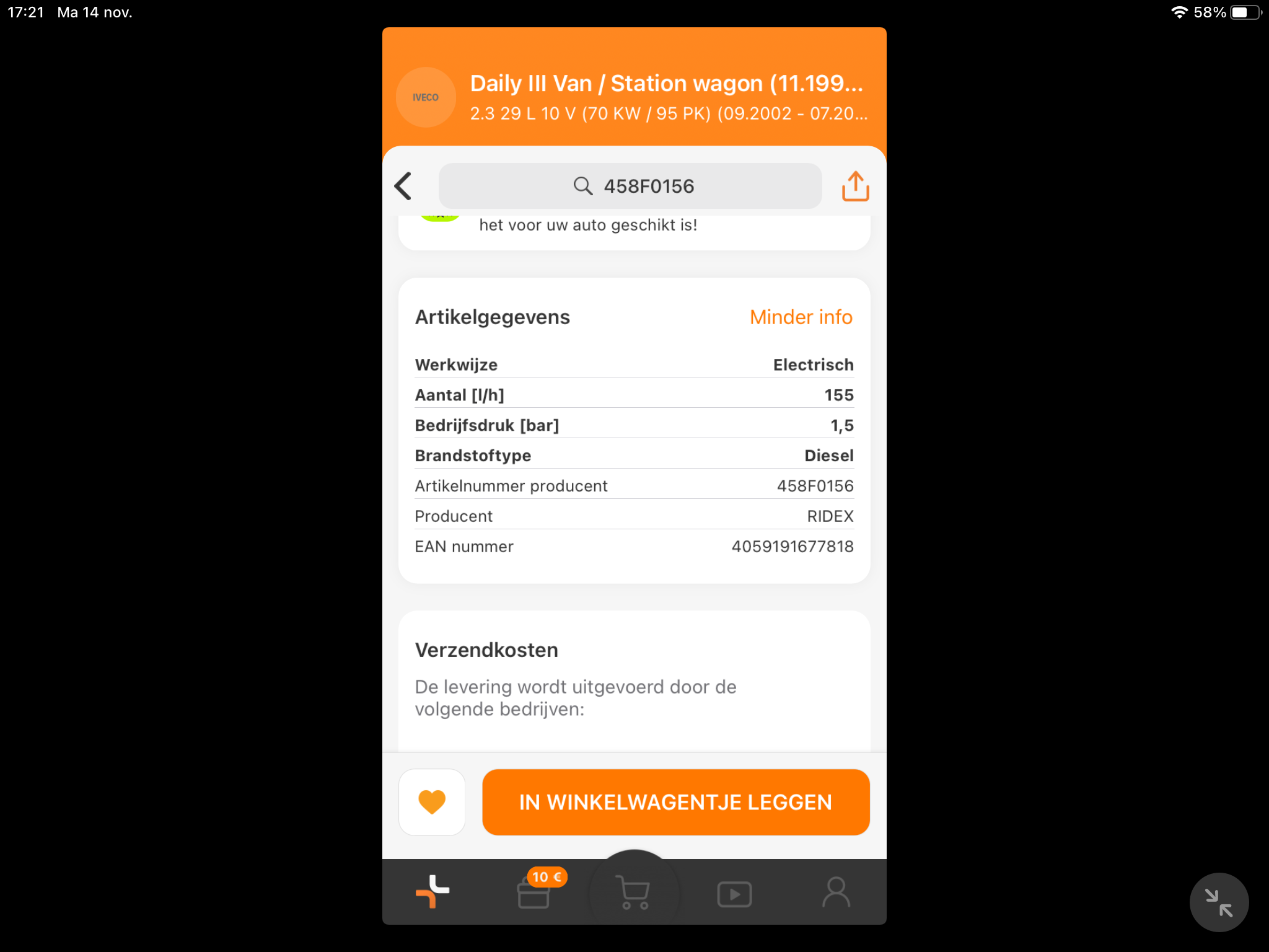

Re: engine runs, but pops out of the exhaust
Verfasst: Mo Nov 14, 2022 4:30 pm
von Kneggie
The specifications of the fuel pump that I have installed.
Die Spezifikationen der Kraftstoffpumpe, die ich installiert habe.
Verfasst: Mo Nov 14, 2022 6:25 pm
Dirk hat geschrieben:I think the engine is getting too much fuel. The spark plugs checked, spark plug 1 to 3 light brown and spark plug 4 pitch black.
This is too much Fuel on #4.
But it should not kill the Engine.
3 working Cylinders are enaugh to keep it alive,
At the Moment I run out of Ideas with my Experience ... :?
Edit: Try another Set of Spark Plugs. I had a Brand New Set and one of the NGK failed as it came out of the Box.
Fortunately I knew the Engine was running properly bevore I put new Spark Plugs im it ... :shock:
Good Luck Axel
Verfasst: Di Nov 15, 2022 8:46 am
Hi Dirk,
I use a Gauge like this one to make shure the Bike has korrekt Fuel Pressure:
https://www.ebay.de/itm/295092003121?mk ... Lqahsd1w75
Good Luck Axel

Perhaps such a fuel pressure gauge that axel posted could help. Fuel pressure should be boost pressure + 0.1 Bar.
Verfasst: Do Nov 17, 2022 7:08 am
Georg hat geschrieben:Fuel pressure should be boost pressure + 0.1 Bar.
Fuel pressure should be boost pressure + 0.2 Bar.
Good Luck Axel
Hi Georg,
I had read over your piece, sorry.
The first time I had driven 34 km, the engine started to struggle after driving with turbo pressure for a while.
The second time, the engine wasn't even warm. And I had to hold back for a few cyclists.
The day before yesterday I replaced the 4th spark plug for a platinum spark plug, at the first start a mega bang in the exhaust. After this the engine started well and continued to idle well. So different spark plugs was a good tip from Axel.
After this I didn't go on the road again because of very bad weather here. And I only have a good week left, after this I can't go on the road for 3 months. Measuring the fuel pressure while driving seems to me to be useful, at least you know what's happening.
