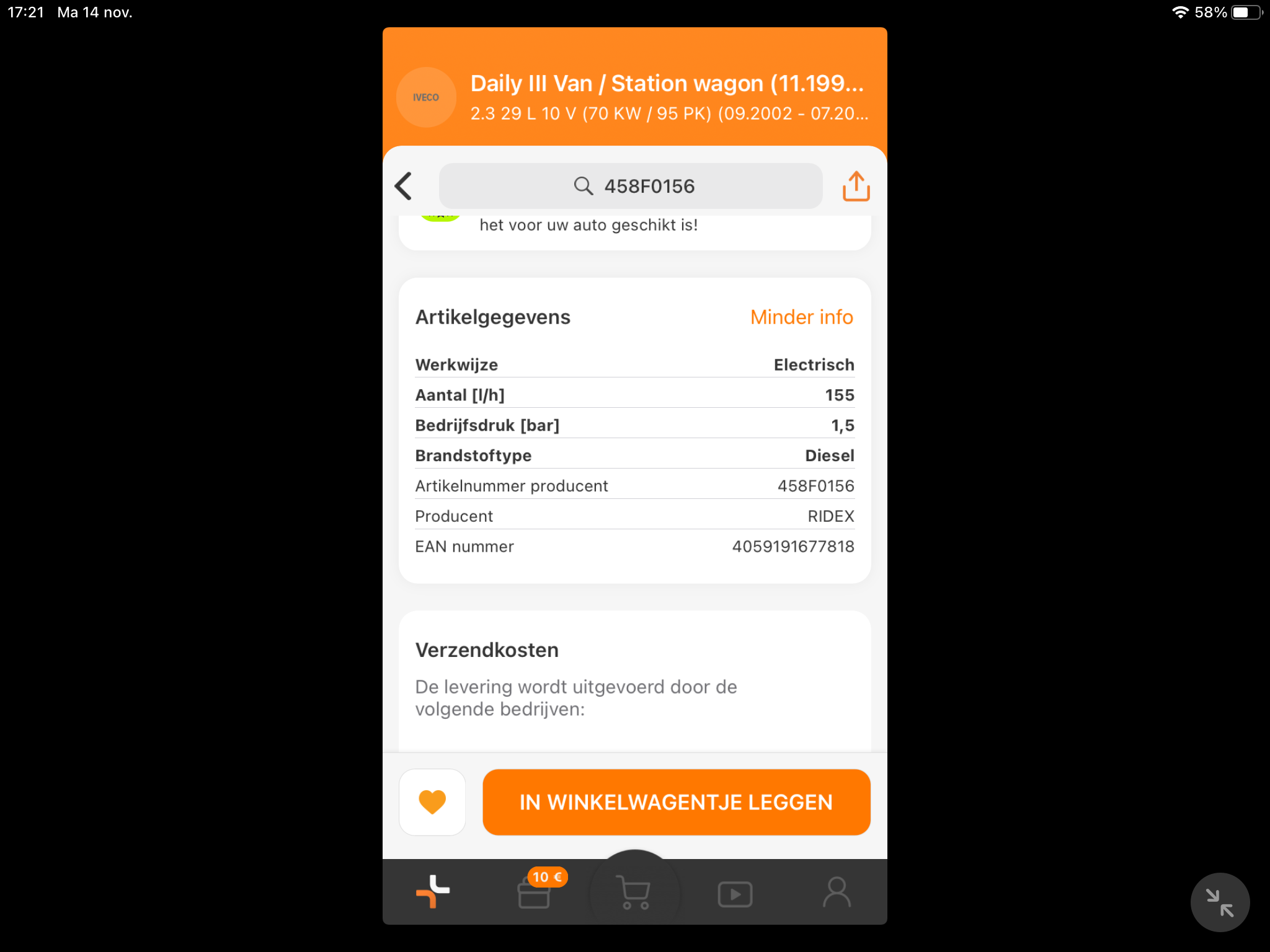

The specifications of the fuel pump that I have installed.
Die Spezifikationen der Kraftstoffpumpe, die ich installiert habe.
Cheers, Dirk

There is a new fuel pump with supply line. New filter, the original point filter is no longer in it. So it can't be that.
Cheers,
Dirk
